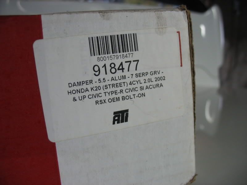

I just got a ATI super damper, RSX typeS fitment, 5.5". I have only looked at it and have not yet read the directions,
UPDATE
I decided to use the ATI on the K20 and ordered up a custom one for the K24 engine(but in a 7" dia.).
Here is the ATI SuperDamper compared to a stock A2 crank pulley.
the ATI part#
and installed
I have to say there is a very noticable reduction in vibrations, much smoother at idle, and with the A/C on the only indication is a slight change in engine tone!

ATI just happened to have one built and on the shelf when I called them. They did say they had enough inventory to build 20 or so more. The stock damper slides on and off the crank snout with no real force at all. And after reading the directions, which are not specific to the serpentine series, it appears that they need to be hone fitted as well, they give a nice chart to determine the press-fit dimensions. With the proper tools this only takes 10-15 minutes extra time to install over a stockie.
Doug

I had ordered it directly from ATI after calling alot of shops and them not knowing of it. I had to really dig thru ATI's online pdf catalog to find the small print saying the K20 dampers are special order. I have not had a chance to weigh it, later tonight I will, this will be replacing the EP3 crank pulley that is on the A2 now, so I will not be able to give you a weight comparison to a typeS stockie.
Doug
